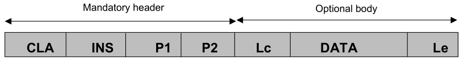

关于Smart Card Communication
  • Card Acceptance Device(CAD): supply the cards with power
  • half-duplexed communication model
  • master-slave mode: CAD is the master, Card is the slave
  • Application Protocol Data Unit(APDU): ISO 7816-4
  • Command APDU(C-APDU): from CAD to Card
  • Response APDU(R-APDU): from Card to CAD
根据APDU规范,每行C-APDU命令的前8个十六进制数字分别对应CLA INS P1 P2,每个字段占一字节,称为Mandatory Header即
CLA INS P1 P2
00 20 00 0A
00 A4 00 0C
00 D6 00 00
CLA: Class of Instruction
INS: Instruction
P1, P2: Parameter 1, 2
后面的字段称为Optional Body,根据Header中的命令需求,分别有:
LC: Length of Command Data
Command Data
LE: Length of Expected Response
例如
00A4000C02 + 3F00
00表示CLS,A4表示SELECT FILE命令,00表示select EF, DF or MF by file identifier0C表示File Control Information(FCI) returned in response

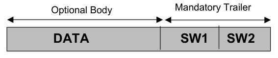

02是LC,表示Command Data长度为两字节,3F00即MF。
R-ADPU
SW: Status Word
例如9000时表示SELECT FILE OK
