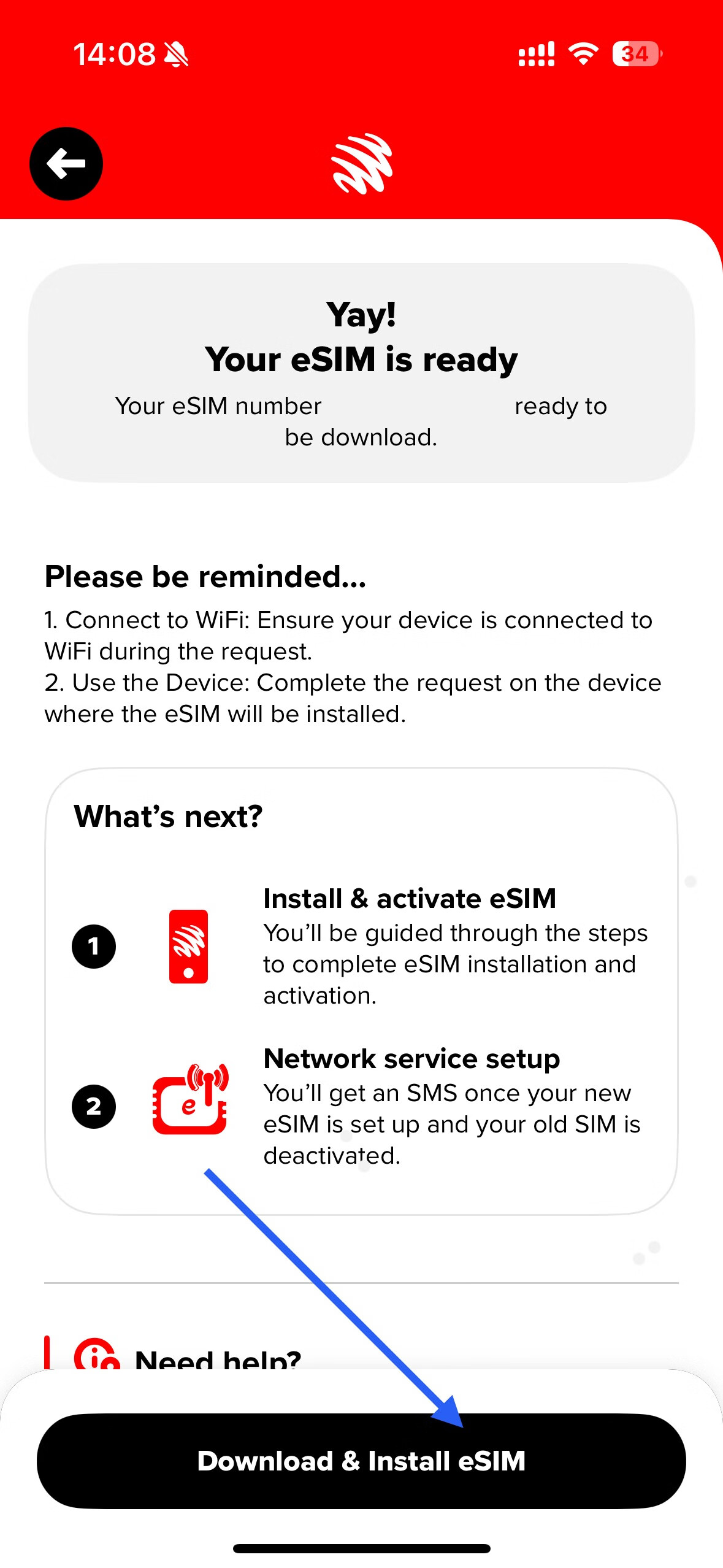

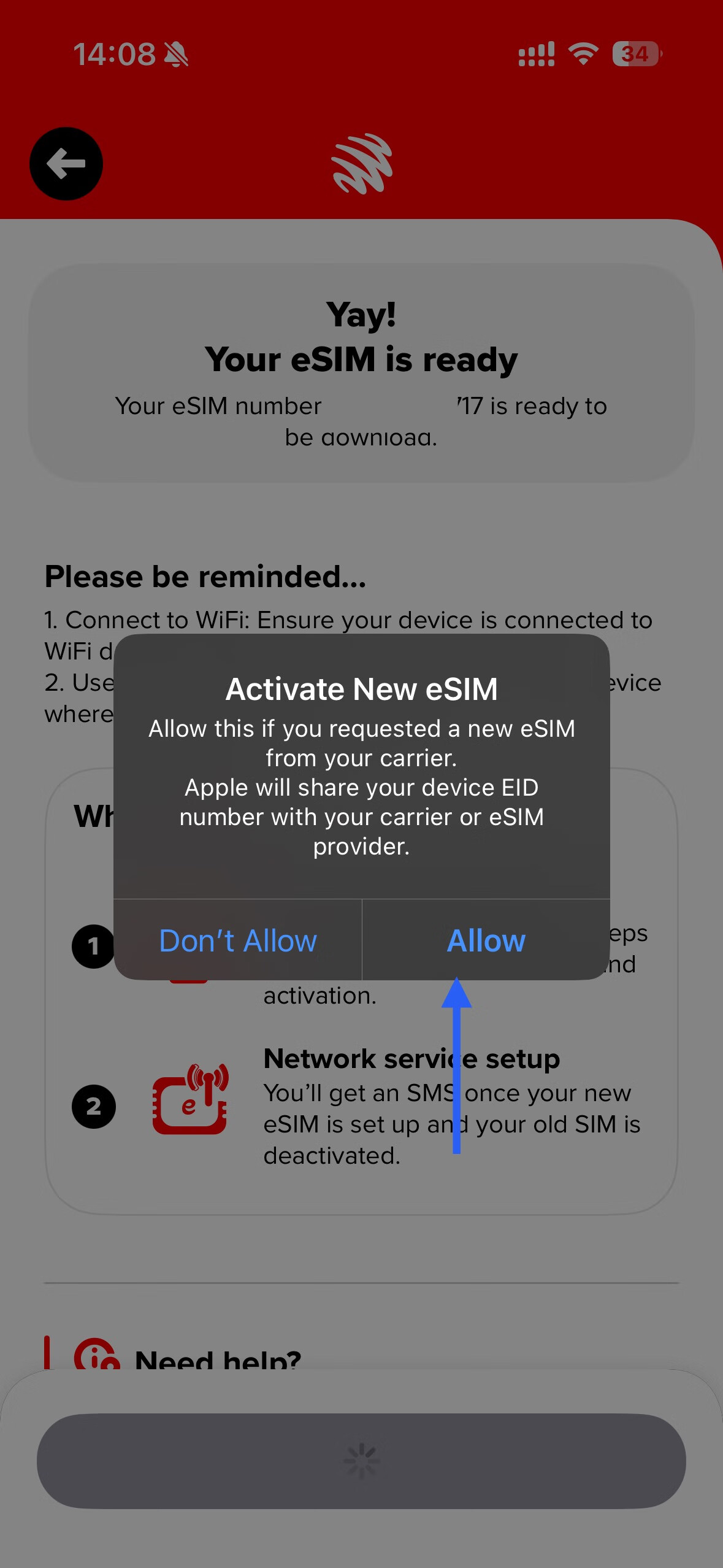

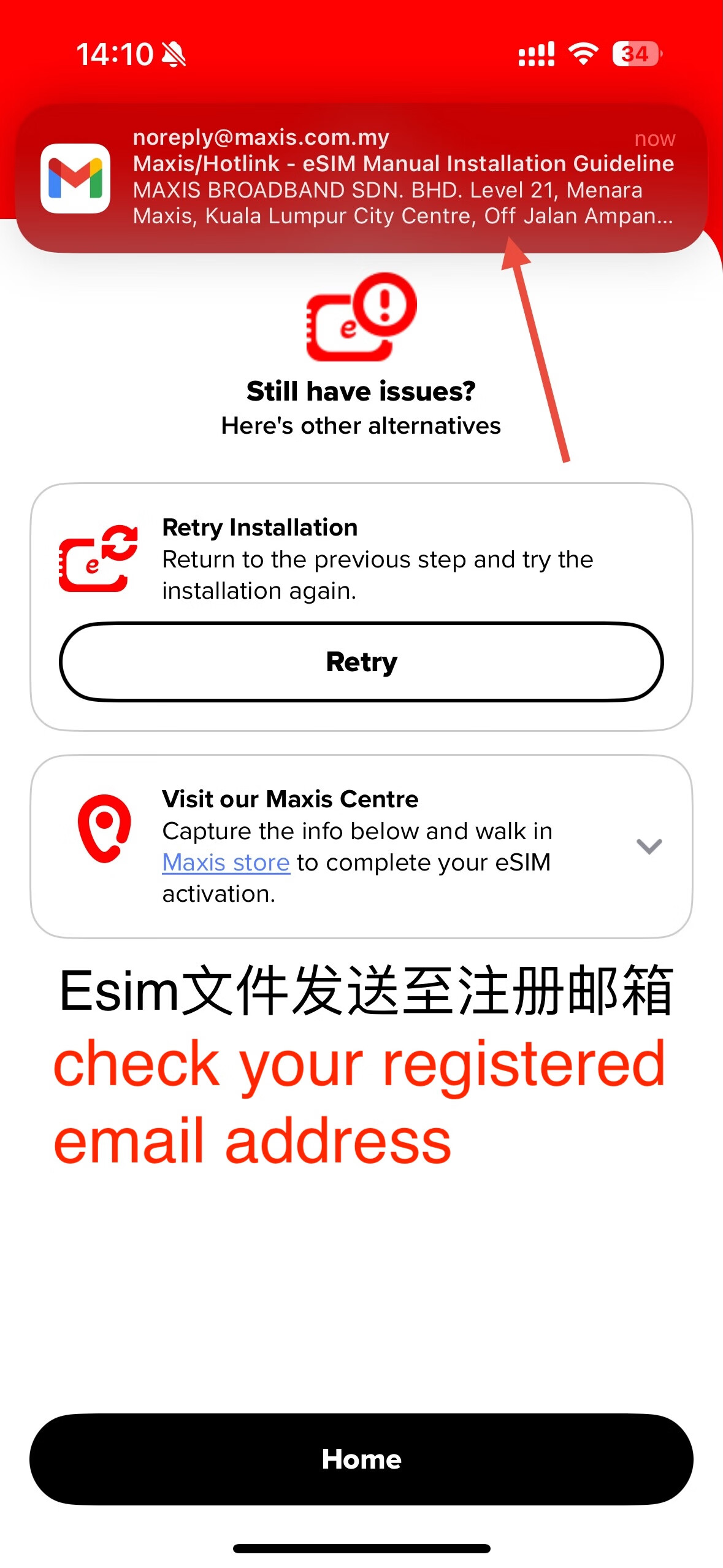

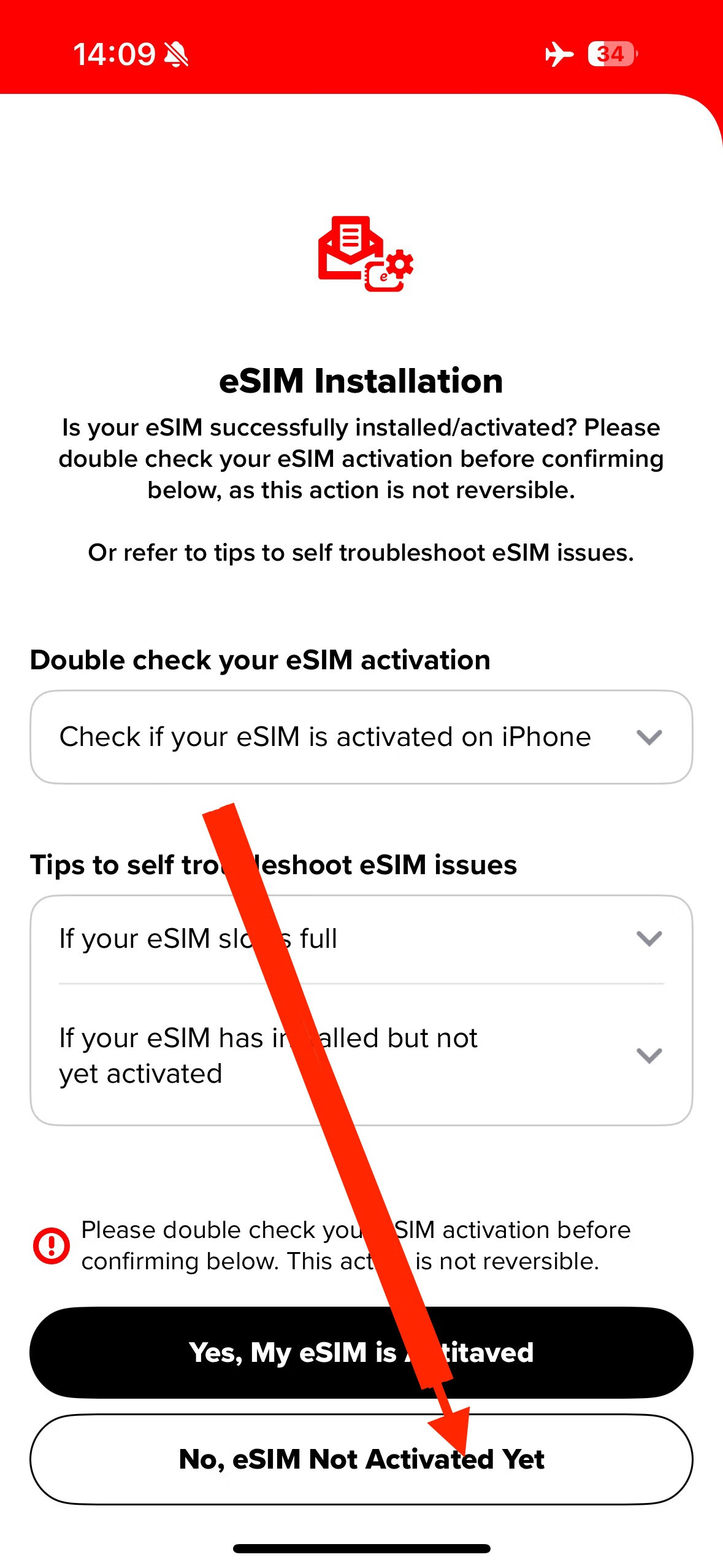

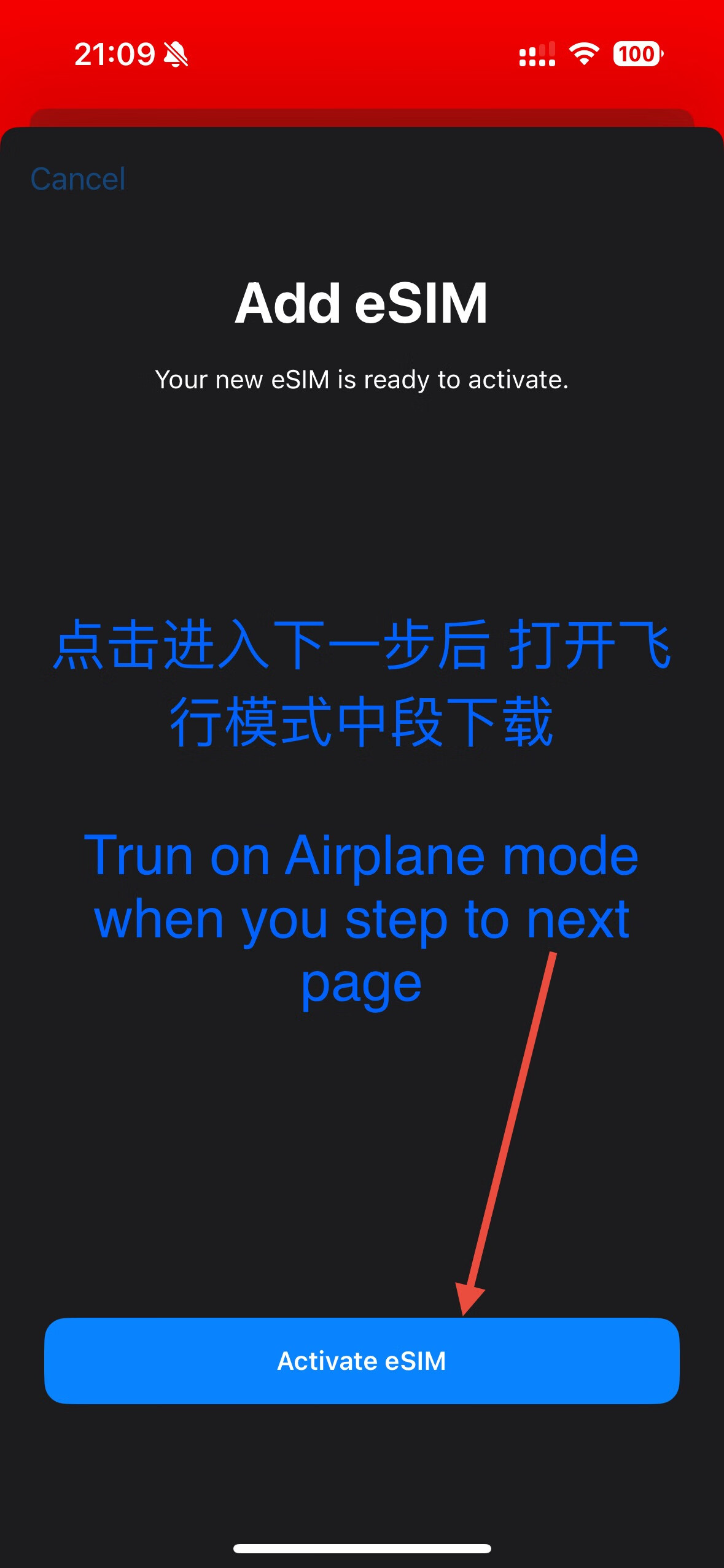

背景:
Hotlink每次更换esim时需要花费5MYR(1.2USD),于是想把esim写入到estk中。
最初需在原生esim手机中才能唤起esim安装,
原理:在下载esim的过程中断开网络连接导致下载失败会触发esim文件回自动下发至注册时预留的邮箱的功能, 从而可以用来写入其他设备:
Start:
Esim swap chaeges 5MYR(1.2USD) that leads me to curious about how to get the esim profile install at Estk. As we know, esim-capabled device is required to launch the installation with Hotlink,
How to make it:
By interupting the esim downloading process to receive the esim profile to the registered email.
